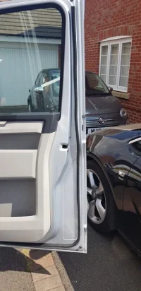

I had a look at this again today. The door still had the 12mm seal on in the outer groove position (this shut but didn’t sound very good), it also had a strip on further inside the door of the THQ seal just seeing for testing (again it closed but didn’t sound any better)4640EE61-91CE-46EA-BDED-B65567A277D7.webp
So I gave up with all that and instead fitted the TL seal
Like the Caravelle seal from an earlier post this is not symmetrical.
So I put this is on and it is definitely better but still doesn’t close as easy as the passenger door. I have now cut a slit on the inside every 6” on so and again better. I have left this on now in the hope that the seal will get better over time.
The door also sounds noticeably more tinny than the passenger door so I hope this be improved when I have fitted some deadening

3rd pic Don’t think thats in correct Place
1st pic what’s the extra seal half way down?
