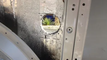

Oops I meant bumper, not bonnet!Mine is at the back under the bonnet, still plenty high enough to avoid damage when reversing. You can see it on attached photo.
