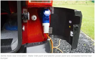

@T6 Dave - This looks a very neat arrangement for your suggestion of placing the electric hook up under a panel below the rear lights. The picture is from Cameron McNeish's test report on Jerba's Cromarty campervan. His report can be found at:

@DaveyB, now that you have refitted your 240 hookup, here is an alternative on a T6 ;).
@Richard just a heads up ,if you have side scan the sensors are behind these rear bumper sections.
Good luck with your install. Mines under the hood. ( bonnet )
@Stampie66 Thanks for the heads-up but I haven't specified Lane Change Assist so assume that side scan sensors are not fitted. When I saw the picture last night, I thought that it was a more elegant place for the hookup than the off-side panel where it is usually placed (and I expect mine is/will be fitted by the converter).
@Fish I would say that there must be because that is a T6 :). Check out the review on the author's link :unsure:. Might be worth contacting the converters, but they look to be stock parts with the socket being an elbow fitment ;).
Theres quite a bit of space behind the foglight cover, obviously directly behind it is the rear of the foglight unit but around it there is a reasonable amount of space where im sure you could figure out a mounting solution but think you would have to have it fitted in a particular orientation to get it screwed in, not sure going through the foglight cover would be good for anything other than occasional use, every foglight cover i have taken off a T6 has been an absolute bitch to get in/out so i would suggest a cutout/hinged section would be better IMO
