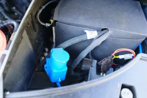

I followed the instructions on travelvolts site (got parts from there too). Basically there's a grommet high up on the passenger front wheel arch that comes out directly behind the starter battery so I just pushed enough cable through to get to the front of the battery and then attached the hook up plug . It now can't go anywhere so I didnt bother screwing to the van. The cable then runs back to my rcd box which will be in the rear furniture once I fit itThat under bonnet is great idea. But how/where are you getting through the bulkhead, and terminating in an outlet where?

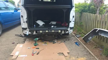

Well done @DaveyB what have you done with the bag of spare fixings you have left overAs mine were mounted to the underside of the van and looked like two plastic Halfords pretend exhaust pipes, today I set about moving them.
Had a look in the bonnet but could not see anywhere I would have been overly happy mounting them both, as I have 230v in and out.

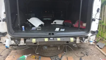

So got down and dirty under the rear bumper to see what I could do. After offering them up and figuring out where they could go, the only option was dramatic - rear bumper off. Scratched my head for a while, then took to the internet, 5 minutes later I'd worked my magic and her panties were off, with her naked rear hanging in the cold air.
As you will equally see, the inlet was then mounted to the nearside and the outlet to the offside.

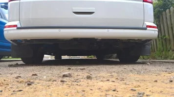

With everything back together you have to get down on your hands and knees to look under the van to see it, and even then the only one you can see is the end of the blue cap on the nearside.
Definitely happier with outcome. Bloody glad I did take all the sockets apart as I found another reason why no-one should ever take their van to Rising Sun Campers nr Coventry. Both the Neutral and Earth on the inlet socket were not secured into the terminals. In fact the terminal screws were so badly burred could barely back them out. Pulled them out, nicked a couple of new ones out of a 30A terminal block and tightened it all back up. So that's the 230v plugs I have found with loose wires, as well as all of the connections on the neutral post of the leisure battery under my seat that they also installed which what I traced the fault back to when the internal lights, inverter, and amp stopped working. Reckon I will now take the consumer unit apart to check all of the connections in there as well prior to hooking up to a 230v supply for the first time.
