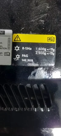

So is 5w 30 OK
That label shows the requirement for the lubricant in the Air Conditioning system (J639)
5W-30 is fine for the T6 if it is also VW 507 00 spec as well (Low SAPS so it doesn't block the DPF)
SAE J639 is refrigerant oil, nothing to do with the engine!
5W 30 is a viscosity, not a specification, you need VW 507.00 specification, and the viscosity will be correct within that specification.

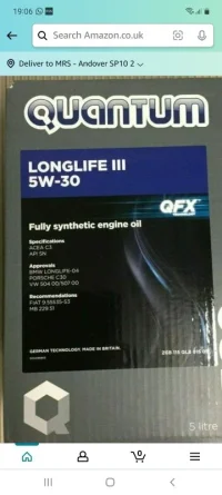

So this well be OK
Yes, see the label under Approvals? VW 504 00/507 00
But you're gonna need another bottle. 7+ litres in a T6
