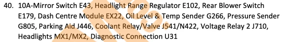

"Oil sensor, visit workshop" warning still present on dash and cannot be cleared (which in turn provokes an engine light immediately after starting), but no clear information regarding *which* oil sensor it is. There is an oil temperature reading on the DIS. Parking sensor circuit still absent.
Could it be a fuse? One fuse box diagram for the T6.1 I have suggests fuse 40 powers parking sensor unit and the oil level / temperature sensor, but also a bucket load of other things that I would have expected to stop working as well.

I've also downloaded the circuit diagrams that depict the supplies / fuses for both the oil temp/level sensor and the rear parking sensor controller in an attempt to see if there is any common feature between the two that could explain how both circuits went down the day before the fuel supply failure. The VIP downloads section is a gold-mine, very impressed that these documents are available through the T6 forum. I should make it clear though that I am a novice at understanding wiring diagrams so if I have misunderstood anything I am happy to be corrected.
This revealed the following (excerpted from both diagrams, hope that this is permissible, apologies if I have transgressed - if they need to be removed, please do so).
Firstly - Page 26 of the CXHA circuits, G266 is the oil temp/level sensor.
Associated power supply - "B278" - +ve connection 2, 15A, main wiring harness.
Associated fuse - "SC30" - Fuse 30 in fuse holder C
Associated earths - 367, 368 (Earth connections 2 and 3, main wiring harness), 636 (earth point, onboard supply control unit)
Associated connector - T3bc, 3 pin connector on underbody.
Secondly - Parking aid control diagram, pages 2 and 5, excerpts pasted below.
J446 control unit (grey box at the top of diagram)
Associated power supply "B278" - positive connection 2 (15A), main wiring harness
Associated fuse "SC30" - Fuse 30 on fuse holder C
Associated earths - 367 and 368 (earth connections 2 and 3, main wiring harness), 636 (earth point, onboard supply control unit).
So if my understanding of both diagram sets is correct, the oil temp / level sensor AND the parking control unit share power supply from B278 "positive connection 2, main wiring harness", Fuse SC30 (fuse 30 fuse holder C), and all three earth points 367, 368 and 636, as well (if I believe the 2020 T6.1 interactive fuse box diagram), fuse 40.
Could this suggest a single point of failure to home in on or have I completely messed this interpretation up? I guess the starting point would be to look at those fuses as they are probably the single simplest thing to check and replace ; if instead there is potential wiring / connector damage to find and resolve that would be an entirely different level of complexity.
Decided to start with the simplest action first. Check Fuse 40 in fuse box C under the steering wheel.
New 10A fuse fitted. Parking sensors restored immediately, and oil sensor warning did not appear when van started up. Engine light cleared and warnings about stop start also gone.
Obviously I would be happier if I knew the root cause of the fuse blowing (ie loom damage somewhere, malfunctioning component in a different system supplied by the same fuse etc. or even something simply sporadic), but right now I am pretty chuffed at being able to restore function.
Given the long list of other systems supplied by fuse 40 as cited above I am astonished there were no other symptoms, although it is plausible of course that many of them are options that are not fitted on my van.

3) investigation of wiring diagrams and fusebox using various documents in the VIP section suggested Parking module and Oil senders have substantial commonality in terms of power supply and earthing, although a little confusion to begin with over whether these were downstream of fusebox C / #30 (a.k.a. SC30) or fusebox C / #40. The fusebox diagram suggested #30 is "5A Light Switch E1" with #40 supplying a large number of systems inclusive of Parking module *and* the oil level / temp sender. The current path circuit diagrams suggested Fuse SC30 is upstream of a similar list of systems including the Park Assist module and the oil/temp sender. So which is it?
The fix in my 2020 T6.1 was replacing fusebox C #40 which is a 10A fuse. The explanation for my confusion is that there are a few differences between T6 and T6.1 in terms of fuse nomenclature, particularly in fusebox C - and it is therefore necessary to exercise a little caution when using reference documents that are useful for both but have occasional detail differences.
