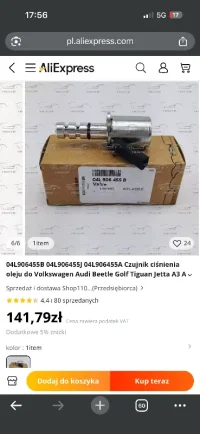

Looking at your pressure valve, I think it's a fake from AliExpress!!! One seller also offered me one, but it looks different from the original!!! There were supposedly VW badges, but as if someone had burned the original with a soldering iron, it looks different on the housing.

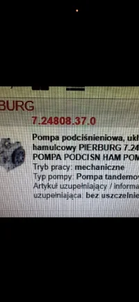

I can't check the oil now anyway because I just changed it. I'm struggling with the P164d pressure, and the oil has maybe 10 miles on it. I want to buy a Pierburg pump, but this part number isn't available anywhere. They only fit passenger cars with a different part number. Can I buy a different part number? It looks identical, except for a different intake manifold and, I think, a different pump drive gear?
