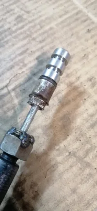

I have succumbed to the fact that I wont get it out and dont want to risk getting filings into the oil system. So its going to a mechanic to sort out and curse at this.. lol
