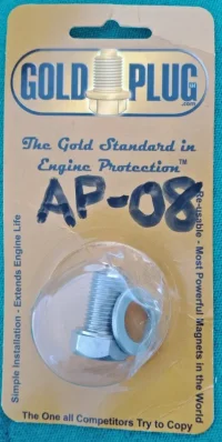

Can anyone recommend a magnetic sump plug.......or, now don't laugh........would it be possible to magnetize the standard plug?????:thumbsup:
Not the T6, but on my old Landy, I have the magnet from an old hard drive attached to the sump plug. It confused the MoT tester the first time he saw it.
I have one for my T6 but the dealer refused to fit it for "warranty " reasons :(
Just changing my oil today, pulled the plug and found a lump of tar like substance stuck to the magnet. It would seem to be doing its job.
