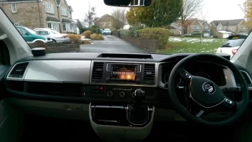

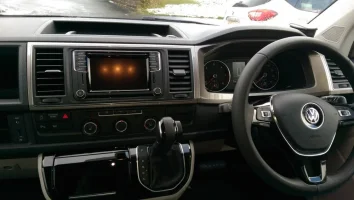

Phase 2 of dash modification.
I will put some photos in the media section ,showing what bits to trim .
1)bottom of right vent need a small amount of trimming.
2) bottom right corner of clock bezel needs a small amount of trimming.
3) centre heater vent /radio surround ,fits straight in .
It took about an hour to trim and fit the 3 parts .

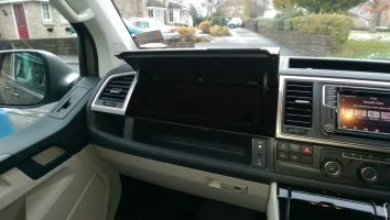

Tomorrow is the big job ! Fitting the glove box .
Agreed. Already a vast improvement. Great to know its easy to fit so far. Detailed write up on the glove box would be great.

The tray with lid won't fit, as it's a different shape. That's gunnna need some serious cutting.
