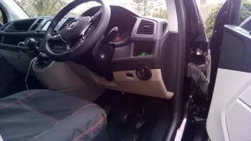

@carlg can you list all the parts you used for that 3/4 dash please? This open T6 dash, no coin holder and stupid angled holes under the side vents malarkey is really bugging me!

You need ,l/h vent ,glovebox,centre vent /radio surround,clock bezel and r/h vent there are a few colors .
Centre console comes in 5 pieces.
The price for it all is around £850

Which bits are you after @Diesel9a1
Carl has fitted a biege dash to match his paintwork so his part numbers wont work for you.
The parts are split into two areas the lower centre console and the upper dash gloss trims
The centre console is the easier of the two to fit as its all bolt on (but does leave a small gap in the flooring) and the upper dash parts are a bit more involved as the upper glovebox doesnt fit in without part of the original dash trimmed out behind it
I have both sets in stock in gloss black if you are interested and can get the other colours if required

The lower centre console is a standard colour either grey (van) or black (caravelle) its only the top gloss parts that have colour options

You have trim a plastic cable cover ,which goes round the bottom of the gear leaver .
If you have cab carpet this will also need trimming (you can cut a piece off and fit it where it's short on the left hand side )

The carpet is short on the passenger side foot well .if you try the new console first you will see it .There is some spare that is covered with the new console that can be trimmed off ,on the passenger side .
Just keep trying it in and only trim a bit a bit off the front till it fits .
