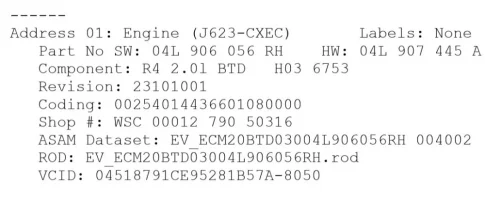

What's the software in the engine please - VCDS scan of ECU = 01-Engine would reveal that.the display flashes up continuously with 600 miles left..

Thank you - again! Realized that you actually already had provided full scan earlier - I should try to keep better track of thingsDoes this help @mmi
So is the 600 miles left wrong? Certainly the "narrow range" for the fill is a bit strange. Does it then take 13 litres? Any fault codes?It bugs me that the display flashes up continuously with 600 miles left.. it asks you to fill with a minimum of 2.75 gallons and maximum of 3 gallons.. so thats roughly 12.5 litres to 13.5 litres..
No problem @mmi..Thank you - again! Realized that you actually already had provided full scan earlier - I should try to keep better track of things
