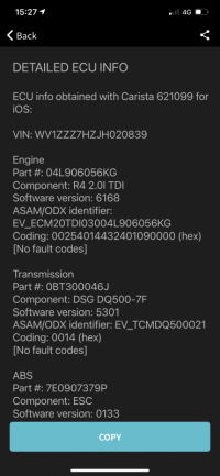

i have a Carista and when I use the emissions test it stats NOX/ SCR monitoring not ready.

Thanks. Indeed the software is the latest one.
In the VCDS there are a few functions to reset/adapt various related things however I find very strange if the earlier mentioned channels were not available.
Thanks for checking that for.
