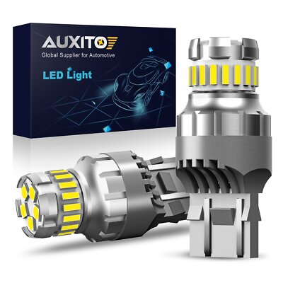

I went for these, as recommended by others earlier in the thread. No bulb warnings unless your starter battery is really low which may trigger a warning. It clears next time you start after the battery has a bit of charge.
LED DRLs

Not sure if this is from the same thread, but slightly improved version. Will either get these or the Osram ones.
Thanks all. Spotted they do a ‘better’ version now (scores 9.5/10 on their canbus scale versus 8/10 for the old ones)
I don’t think Osram do any Canbus friendly DRL bulbs for the H7 headlights anymore. If there are some pop a link here please.

There’s an accompanying Osram control module for CANBuS. I’ll make this easy for everyone and just follow the pack on the Twenty20s. Thank you.
I believe the LED bulbs in that kit are not Canbus friendly. They are the same as the ones here at ABD and they say no to Canbus. They have them in Halfords and it says nothing about being Canbus compatible on the pack.
Thank you I’m convinced on the Twenty20s.
