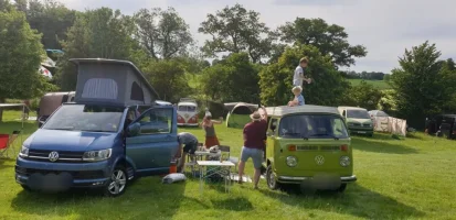

After visiting VWVC, we then finalised our decision for @Exploria Ltd to continue our conversion journey. For ~12months I'd been considering the usual companies and, after a visit to Brighouse (which is ~180miles away!), decided that they would do a fantastic job with our long list of jobs...
- Painted Reimo slim-line SWB elevating roof with poweder coated Reimo active rails for roof bars
- Elevating roof trimmed in Alcantara and Exploria roof bed trimmed in GTE fabric
- LED colour changing surround lighting in elevating roof strengthening frame
- VW rear-quarter windows, all rear windows tinted 20% and VanX blackout curtains to all rear windows
- Ply line all walls/door cards and line out in J Brownd McKenzie Indigo herringbone fabric
- x6 LED warm white dimmable spotlights on 2-way switch in to elevating roof bed and x2 LED warm white spotlights in to tailgate
- One piece, 12mm ply floor with Karndean flooring
- Multivan/caravelle side step
- Multivan sleeper pack and 2" mattress topper
- Sterling DC to DC charger and Sterling 30amp 240v battery charger
- x2 underseat 110AH low level leisure batteries
- Fuseboxes, battery level indicators, breaker, underbody 240v inlet socket, x5 12v sockets and x3 240v sockets
- 250w Photonic Universe semi flexible solar panel and Victron 100/20 solar regulator
- Webasto diesel heater (underslung) with OEM ducts to B post pillar and 7 day timer
- x2 Reimo Multirails
