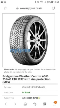

Do you think the 8.5 et45 would look good and the right fit, the 18" alloys i am thinking off are load rated but only come in et45, will they catch! On 245 45 as they go about 15mm closer to the suspension. I've read so much, some say they don't catch some say they catch!!
I am just trying to make the t6 look a bit better, I didn't want to slam dunk it! And I don't want to lose the ride comfort etc

So the 17" Devonports you already have, also come with a 235/55/17 tyre on some T6 variants; so these tyres will sit 10mm closer to your structs (This is what my van came with); so 14.4mm closer as shown on the drawing is only an extra 4.4mm closer than the wheels mine came with; therefore I'm 99% sure they will be fine, as there is no way VW OEM would work to such close tolerances in terms of mud or ice build up in such a small gap.
So you can safely go with them imo; and if when you've got them you feel like some spacers then no issue. I would have spacers depending on your tyre section width maybe 25mm all around; but I would fit the new wheels/tyres first before deciding.
The bridgestone A005 you show in 255/45/18 are a perfect match imo, and should be a comfy ride no problems at all.
