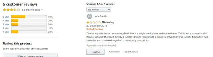

yep, thats just a Diode(one way power) and resistor(current limiting) in a plastic box . . . . . . so expensive for what it it.
Thing is your starter will always be charged to 80% (stop/start/bluemotion) . . . . . so via the (VOTRONIC - StandBy Charger) the starter battery will always drain power away from the Leisure battery to equalize the two batteries. . . . . unless you have constant solar or EHU to keep the charge level high. ( then it will work great and both batteries will have a full charge)
but it will only work if you have a constant source of charging power . . . ie solar or EHU.
But if its just the two batteries or solar on cloudy day or winter. . . . . then the leisure will just drain down into the starter untill both are at the same level (voltage / potential).

the votronic has no relay . . . see the Amazon review of the guy that bough one and opened the case.
