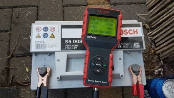

The swapped battery was a Bosch one from my old T5.1 (a known good), its a standard wet-cell, not a EFB+ like the one i took out. (didnt matter as the REDARC was back in now and would charge the battery normally)

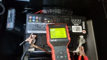

This is the MOLL EFB+ after weeks of driving around and after being charged. it should be 100% full, but its showing 66% SOC and 77% SOH and 12.4V

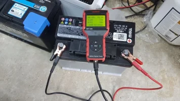

this is the replacement spare im going to use.,,,, its been in the garage for 3months so not in the best condition....
it shows 40% SOC, 73% SOH and 12.24v before being fitted in the van.
Now the van has been sitting all weekend, but after todays work, about 4hrs driving around with a rest in the middle look at what the new swapped out battery is showing . . . .
98% SOC 74SOH and 12.58V . . . . . . . Its charged up fine and held the voltage.!
Now look at this ---->
The MOLL EFB+ that was removed on friday had been put in the garage and put on a NOCO charger for 2day............ 2 DAYS!!!!
so it should be full right ?
Well look at this, after 1 day just sitting there doing nothing..........................
48% SOC, 100% SOH and a voltage of 12.28V !!!!!!!!!!!!
So basically no matter what you do with this battery, as soon as you take it off charge the SOC drops to bellow 50% and the voltage drops to 12.2v or bellow . . . . . .what the hell!!!!!
Its a MY18 Van. . . . . . . ! with new batteries!
So it looks like the MOLL EFB+ battery is the reason why all my test results are so far out. . . . . this battery takes a charge but then just plummets in SOC and voltage as soon as the charger is removed.
Now the good-old Bosch battery is in the van it seems like all the levels are as they should be.

Conclusion so far? - Brand new MOLL EFB+ leisure battery is knackered and refuses to hold a charge above 12.2v

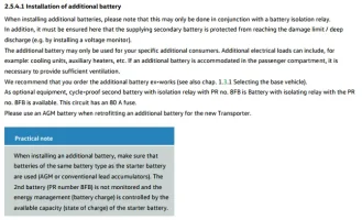

VW guidelines about aux battery retrofitting in document "Volkswagen Commercial Vehicles – Body builder guidelines, July 2018 edition, The Transporter – Page 89."

The full document at Body builder guidelines: Transporter - BodybuilderDatabase
