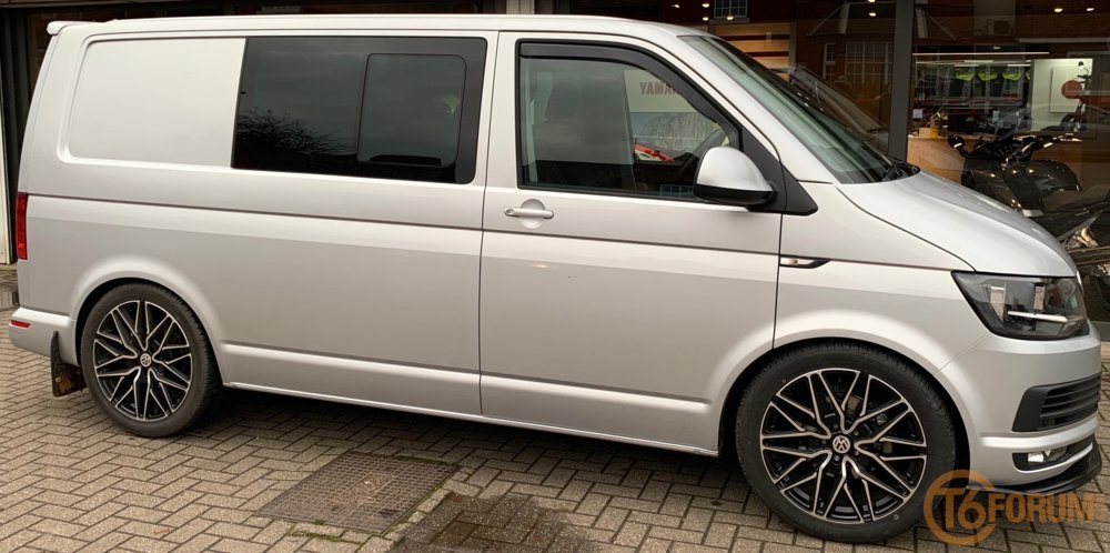

I had the eibach coilys (KW dampers I believe) fitted by VW today. Took it down -55mm all corners but the back seems to be sitting a little lower. Might have to raise it 5mm on the rear to even out.
Fitter mentioned they need a week or so to settle then a fine tune?

I don't believe quality products ( springs ) settle , if they do it would be 1 or 2 mm at most , all 4 springs would do the same and the low rear look would still be the same . However the correct way to measure the rake of the vehicle ( the cars attitude to the road ) is not by the wheel arches . a measurement from the sill line below the doors to the floor behind the front wheels to in front of the rear wheels. the difference in these measurements should be approx. 15 to 20 mm lower in front than the rear.
Most vehicles have a different arch in front than the rear to allow the steering front wheels to clear on lock . I understand the desired LOOK normally gets the better of owners to set the vehicles in a way that isn't technically correct but visually pleasing !
I do like the two tone look however on the Van
