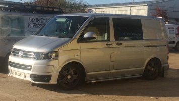

Thought I’d start my own thread for reference. Started out back in 2008 purchasing a 2005 Trendline swb Transporter which started off as a basic 102 bhp van then after 13 years of ownership turned into a lowered, carpeted 220bhp hybrid turbo van.
This is my original Van being transformed from a standard panel van to a coloured bumper. Jeez I thought I was so cool :fast rofl:

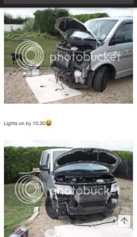

It stayed like this for a couple of years until I done a thread on the VWT5 Forum of which was the front end change to the T5.1 Facelift. Soon after the head gasket blew so while the head was off being skimmed I put in 30% bigger injectors and upgraded the turbo to a hybrid one. Rolling road remap tuned it to 220bhp. Then lowered it on Vmaxx coilovers dropping it down 100mm ish. Fantastic ride on those.
