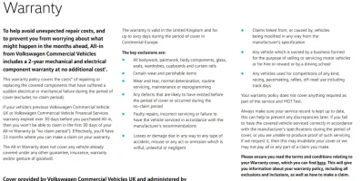

Just to answer a few questions about the ALL-In cover I've had:
quote -
"All-in from Volkswagen Commercial Vehicles has been designed specifically for vehicles aged three to six years at the point
of activation. It provides a comprehensive level of cover for your peace of mind. This plan ensures your Volkswagen aftercare
needs are covered by Volkswagen trained technicians using only Volkswagen genuine parts and diagnostic equipment.
With All-in, we will take care of you for the next two years by carrying out your next two services and MOT tests
and providing Warranty cover and Roadside Assistance for the duration too.
All-in from Volkswagen Commercial Vehicles includes:
What is All-in from Volkswagen
Commercial Vehicles?"
get it here:
see the docs attached:
There are exclusions obviously, but they detail it all in the docs.

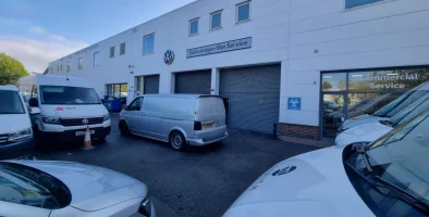

Today was my first experience of the ALL-IN treatment.
MOT and checkover.
( i asked them to check on the previous oil leak ofter they done the Crank oil seal )
and asked them to check the slight knock i could hear when taking the van off load. . .
the day started nice and early . . .
free coffee in the Van center was nice. . . . .
while waiting for the MOT to be done. . . . . . . we could keep an eye on the van . .

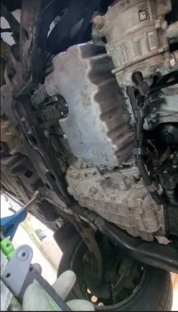

While I was with the mechanic, I showed him this video clip that I took last week.
With the lower engine cover off, and under the van checking that sump oil leak.
With a cold engine in the mooring I could hear the DMF rattling......
Hold on - WTH
I had this done under two years ago, that's only 20k miles ago...... What's going on hear?
(Did they actually replace it last time? Fit a second hand one? Is that revision very weak? Have the part been revised since? - I hope so as the DMF on my last van was fine up to 85k miles..... So what's going on here?)
I showed him this:
He said, yet that's the DMF starting to go.
He said it may be covered under warranty if it was done under two years ago. (Which it is as I've checked now)
So my warranty DMF is now a warranty warranty claim.
So they will have to address it either under the 24mnth parts warranty when it was done at 40k(now 62k).
Or do it under the all in plan I now have.

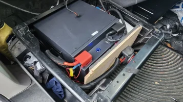

Starter battery keeps going flat, van needs to be jump started after a long weekend.
well after 5weeks, and having the starter battery dead flat for four of them week. (tracker and dash cam could be used to track engine starts and battery voltage)

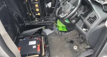

in fact the van event run my lifepo4 dead flat, as the WIFI and tracker were all running for that.
its taken me a few days to get everything back online and charged etc.
had to take the drives seat out a couple of times . . .
im still charging the LB as we speak.

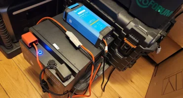

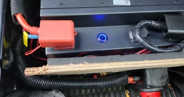

we have swapped out the Leisure Battery for a fancey new FOGSTAR Heated 230ah seat base unit.
