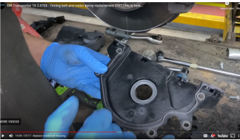

So why the water pump as well. . . . . ?
well the suggestion is the the water pump bearing is weak, and can start to leak.
this leak starts to corrode causing the bearing to stiffen up and ultimately, possibly seize
because the timing belt drives the water pump, this can lead to the increased friction causing heating the belt, and in the event of a seized water pump - total timing belt failure.
due to the engine being and "interference engine" that means mechanical damage if the belt fails. . .
so the idea is a reduce belt service interval - including the water pump, so to catch any leaky water pumps before there is a problem.
more on the timing belt and water pump:

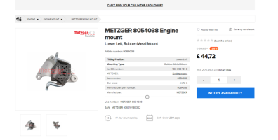

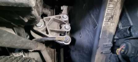

at the same time as the above service 52k miles , we had the Front lower engine mount replaced.
this was a warranty job. . .
07/03/2022​
51948£0.00front lwr engine mount - FOC - . VW

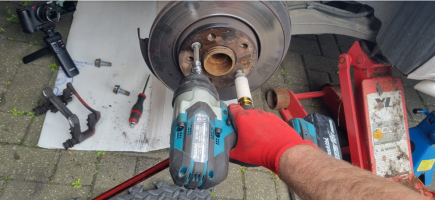

53k was time for new rear discs and pads
13/04/2022​
52827xBrembo rear discs - rear pads - front pads (not front discs)

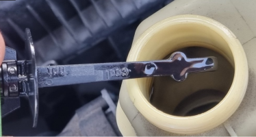

61k miles - low steering rack fluid.
Steering started to feel heavy on 2/3rds lock ..
Checking the levels i found this. (hot engine.)
Eeek.
so low level . . .
but no sign of a leak?
this was confirmed by the Dealer - No Leak,
so the PS oil was topped up.
i asked about where the oil had gone, they said it probably hadn't been topped up ever, so over the last 5years it had just gone down a bit. (wear&tear, oil degradation, evaporation, dilution - wherever, but it wasn't leaking.
topped up by VW FOC during a service.

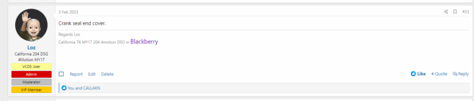

61k - Engine oil leak ( front main crankshaft seal ) - FOC under warranty
26/01/2023​
61289£0.00front crankshaft oil seal replaced - warranty (oil leak)
this was highlighted when looking at the power steering rack low oil above.
this was visible from behind the drivers side wheel . .
@Loz was bang on and diagnosing the front crankshaft seal as leaking . . .
this was confirmed by the dealer while it was in for the service above. . .
it was covered by warranty and took about a day to deal with. . .

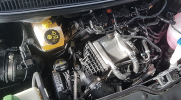

61K miles - EML Light ( EGR Valve/cooler replaced ) - FOC Warranty...

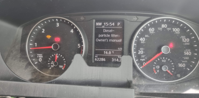

one of the other issues was the Orange EML (Engine Management Light)
this light alone will normally relate to emissions standards and is not normally something to instantly worry about.
it was on for a week or so before i had a chance to scan with VCDS, , ,
when i did, i got this back:
Eml light. EGR valve P0401 00 [236] - Insufficient Flow
Code will come back withing two drive cycles.
Scan data:
23871 - EGR System
MIL ON - Intermittent - Confirmed - Tested Since Memory Clear
Freeze Frame:
Fault Status: 00000001
Fault Priority: 2
Fault Frequency: 25
Mileage: 88316 km
Date: 2052.01.19
Time: 20:12:02
Engine RPM: 1934.75 /min
Normed load value: 58.4 %
Vehicle speed: 107 km/h
Coolant temperature: 90 °C
Intake air temperature: 22 °C
Ambient air pressure: 1010 mbar
Voltage terminal 30: 14.484 V
Unlearning counter according OBD: 40
EGR travel diagnosis: strongly increased NOx emission: 0.00 kg/h
Exhaust recirc.valve 1 bank 1: posit.feedback - Actual value: -103.01 %
EGR travel diagnosis: marginally increased NOx emission: -49.20 kg/h
Mass airflow sensor 1 bank 1 airflow: raw value: 804.0 mg/stroke
Throttl.valve adapt. 1 bank 1: posit feedback - Actual value: 2.80 %
Charge press. ctrl deviation after throttle valve bank 1-Pressure_16_signed_10_mbar: 27.9 mbar
O2 sens. 1 bank 1 upstrm oxi cat: raw value: 1.895 counts
the code would clear down and return again within a couple of drive cycles, so a good indication that the EGR valve was clogged / blocked.
The dealer confirmed the diagnosis, but stated that they needed to do a EGR FLUSH first,
this was highlighted on the report and priced @ £384 !!!!
apparently its done with the EGR in situ on the engine, the EGR pipes are removed and a machine is used to flush chemicals through the EGR valve,
after this procedure, the EGR flow rate is re-tested. . .
if the Flush was successful your are sent on your way as the EML light will stay off as you are now under the Flow Rate threshold.
in my case however, the flush failed the resulting flow rate test. . . .
so i was advised that VW had insisted in a second flush . . . .
which also failed the resulting flow rate test. . . .
The next call from the dealer was to say that that the EGR had failed all the flushing and that VW had now authorised a new replacement EGR under warranty. .
example:
i haven't had any paperwork for this yet. . .
but the replacement EGR/cooler included a new front and rear EGR pipes,
plus a engine coolant replacement and air blead as its part of the water coolant circuit. .
ill update this when i get some paperwork for it. .

while underneath . . . looking to put the lower engine cover back on i say this. . . .
slight dampness on the oil filter housing. ( i know it was dry last week as i cleaned it)
the outer size is 32mm socket to just crack it tight . . . . but it seemed tight enough?
the inner nut is for draining the filter housing before removal. . . thats a 15mm? (needs comfirming as i didnt check)
View attachment 191699View attachment 191700
Careful not to overtighten the 32mm or the housing can go out of shape and leak. The correct nm is usually stamped on the 32mm part.

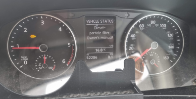

i had a random one the other day . . .
id run the fuel tank down to almost empty as i normally do,
then filled to the top.
on restart:
DPF - Yellow Warning Light
thats very odd i thought.
engine RPM were 800rpm normal, so a regen hadnt started yet.
i done a quick scan with Carista - that showed no engine related faults.
so i zeroed the trip counter and followed the VW guideance for clearing a DPF light.
basically higher revs for a sustained duration: DPF Regen, Yellow Light & Adblue - Whats It All About? -
"3. Drive at least 60Km/hr @ engine speed between 1800-2500rpm, at least 15 minutes until light goes out. (Automatic; Select Sport) Did the light go out?"
so i put the DSG in Sport mode and carried on my journey - i had about 20mins to go till the end of my journey.
just as i was about to pull away the revs jumped up as the van started doing a REGN, you can see the revs are now 950rpm up from 800rpm. (1558hrs)
i carried on with my drive home . . .
it was about 7.5miles, but took just over half an hour, (1632hrs)
keeping an eye on the dash, the revs were still high and the DPF light was still on. . . .
so i planed on getting home and sitting on the drive while to let the REGEN continue to the end.
but as luck would have it,
as soon as i pulled onto the drive and put it in Park,
the DPF light went out and the Revs dropped to the normal 800rpm.
his has only happened a couple of times, but all seems good now.
