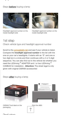

We must be taken to a different site because I'm in Germany is see this:
The osram website says they're working on the approval for T5 and T6. I hadn't seen the bit about LHD traffic though. I wonder why the would be legal here and no on UK roads?
