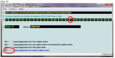

hi guys, just got T6 rears fitted to my T5.1, and i need to code out the `bulb monitoring` as it comes up when i use brakes, all lights work fine, but for the MOT...
i have also just got myself a vag-com from Ross tech, im in witney, Oxon, so interested to find how to change this option, if its possible?

Using VCDS go to 09 BCM, long coding and change Byte 19, bit 7 to unticked.
hi Robert, thanks for your replt above, as a complete novice to vcds do you have a guide for me to navigate, or is there a chapter in the enclosed book that will help?
sorry to be such a noob, but i really done want to get it wrong and F^*k anything up...:slow rofl:
Please see below.
This is procedure for different modification but if you follow all initial steps you will be okay.
Reactions: mmi
Robert your a Legend indeed thank you for your help and guideance!
:mexican wave:
took me a few minutes to work out that 3) was the `bytes` and to select one....
