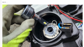

you need to rotate the LED bulb 90 degrees,
i had the same on mine, was a PITA to do after id refitted the headlights and front bumper.
"rear lamp cover off, the rotate that back of the LED lamp, you dont need to release the spring clip as the lamp rotates in its casing."
