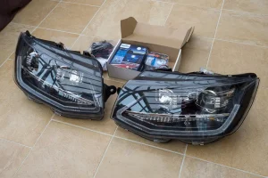

H7 headlamps with LED bulbs fitted

Fitted these yesterday. A fairly easy install though the bumper put up a bit of a fight.
On a quick trip locally they appear to be a huge improvement over the H4s that were on my van.
Unfortunately I do have a dash bulb warning though :(

I opted for the TransporterHQ H7 headlights, and they work fine without any dash warnings, but I still felt like they could be brighter, so installed some H7 Philips Ultinon Gen2 LED bulbs. I now have the dash warning (which I have learned to ignore) but my biggest issue is that the LED’s seem to dim slightly (by around 10-20%) once i start driving.
I have tried the Philips canbus / anti flicker adaptors, but the issue remains.
Has anyone else encountered something similar?

I've got the warning light too but they don't rim, I'm wondering if it will make any difference switching the connectors around as a process of illumination...I think it's not good advertising them and the CANBUS adaptors if they still produce the warning light

Well lights are in. Just waiting for dark now. Did everyone else just stuff the control box inside the unit? There was nothing I could zip tie it to.
Also any guesses where the 2 long black t20 screws came from? Seem to have leftovers and I can’t see anything on the thq video
The short ones go on the inside edge of the headlight (behind grille) and the long ones go under the headlight (behind bumper) ??

Did you get the warning light when you turned then on?
So I’ve no idea where the 2 long black screws came from. But everything seems right.
Just been out to test the lights.
Yes I get bulb warning light on dash
Yes I get a slight dimming after a couple of seconds of starting the engine.
