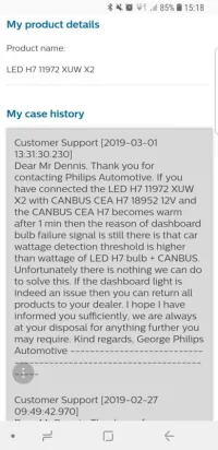

ok so now the mission is to find out how to get the light out....I've emailed Phillips direct as they state their canbus adaptors eliminate the warning....I've also email the company I bought them off and there willing for me to return them

Yes, that is the same CANBUS adaptor I tried (and returned) too. I figure that if I can work out the power consumption when the lights are on, then I can work out the parallel resistance needed and make my own ballast.
