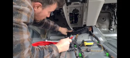

I left an entire 15m roll of arctic cable and attached male end connector under the bonnet behind the headlight, tidy space for it there. You don't need to find somewhere in the van to keep the extension lead this way either. No fittings required and just a 15m hook up extension lead purchased. I've taken the female connector end off the cable that runs into the cab via the DSG cable rubber mount to under the passenger seat ready to terminate to a Charger/Inverter.
