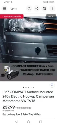

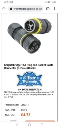

Don't see any difference between this at 38 quid and one of these at a fraction of the price? Obviously the latter would need a decent cap to prevent moisture ingress Screenshot_20220204_150525_com.android.chrome.webp
