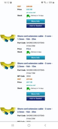

@Doulsy - Just been looking at this unit again. According to the reviews on Amazon, I would need to buy an expensive cable (£150) from Victron also. Is this the case or can the normal EHU cabling be used?
Cable is was under a £100, I will try find my receipt, the cables are far better quality than the normal ecu, much easier to put away, also has a power light.
