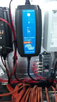

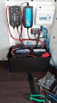

Deaky, do you have the part numbers to the CU and which fuses you used?
been thinking of putting my 240 in there, thanks for posting picturesI used one of these, think one is enough.
They are screw on cabinet hinges@sippe. What are these hinges called and where can I get them from.
Cheers Deaky.They are screw on cabinet hinges

Do you also have links to the waterproof grommets/compression glands?Wylex WBE3 IP65 3-Module Unpopulated DIN Enclosure - Screwfix
Order online at Screwfix.com. IP65. Insulated enclosure for DP RCDs. FREE next day delivery available, free collection in 1 minute.www.screwfix.com
ABB 16A 2P+E Surface Plug 250V - Screwfix
Order online at Screwfix.com. 2P+E. 250V. Compact design, superior grip industrial plug. Connection seal and suspension loop. FREE next day delivery available, free collection in 1 minute.www.screwfix.com
These are what I usedDo you also have links to the waterproof grommets/compression glands?
Is it still easy enough to route the additional cables through the bulkhead?
