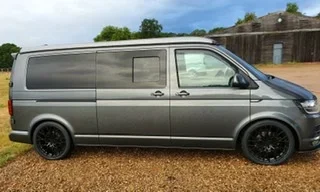

This is my unladen kombi with -40mm H&R springs and Koni Active Dampers. (fitted by CRS).

This is my T30 fully converted camper, with H&R springs and Koni Sport coilovers, also had the H&R ARB’s front and back fitted by @CRS Performance, Wheels are 8.5J 20” ET35 TSW Sebring with 255/40/20 101 XL tyres. The ride has completely changed and the van now handles more like a car, just sticks to the road with no body roll. It’s also slightly quieter in the cab.

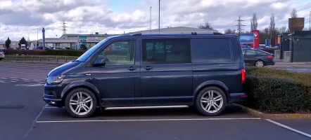

Can I ask what the spec of the alloys are ? They look ideal - thanks !
They are ATS Evolution. 19x9 et48.
Slightly out on the Speedo.
Van reads 60mph and gps reads 61mph.
The front alloy sits 10mm inboard of the front arch, as does the rear, but with a 10mm spacer.
