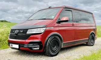

Jay not sure if you were talking to me, but I added some pics up for reference, I know it's not the usual lowered on 20's look and the fat tyres will certainly help with the ride, I'll be keeping these for winters and seeing Steve about some new wheels next summer.
