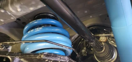

Dropped 50 mm. on a brand new T6.1 LWB 4Motion DSG it surprises me, - just as @TimBath wrote before, quote : " If you have not seen the B14s fitted you won't know that the rear springs are almost fully compressed when stationary" (#52 page 4) - that the rear spring is indeed pretty compressed, without any extra weight int the T6. Picture here below is taken during alignment :
Please correct my reasoning : The more compressed a spring the more weight or power is needed to compress it some more. The guys at Bilstein probably know what they are doing so this compression as shown on the picture is normal under the mentioned circumstances ? Is this setting normal ? Is there a picture available of a mounted spring of the H&R-KONI set ?

That is normal for a B14 rear spring (as with many other similar setups). The springs are progressive and designed to be coil bound, especially on lower settings. The bottom couple of coils are actually covered in a rubberised material to prevent wear due to this.

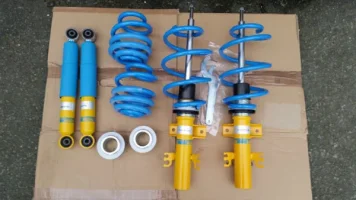

The spring in the B14 kit is not a Bilstein spring and the kit itself isn't made by Bilstein so to assume Bilstein know what they are doing isn't relevant . I have often wondered why Bilstein Germany dont sell this kit . . The issue is that the company that actually make this kit have one spring fits all scenario . The Vans that these kits are fitted to are very different in weights and the heavy vans almost collapse the rear spring , We actually removed a Brand new B 14 kit two weeks ago that had done 1000 miles the car arrived at our workshop 100 mm lower than standard ??? Fitted by one of the leading B14 suppliers . , The kit is a 40 to 70 mm kit as mentioned earlier in the thread . The main problem is that fitting this kit to a heavy van requires the rear adjuster winding all the way down to get close to the 70 mm drop . ( it should get to 40 mm which is the spec but cant !! ) the load on the rear spring once pre tensioned to maximum causes the spring to block out and the bottom pig tail breaks . ( see attached picture ) The ARB upgrade wont help solve this problem sadly .
I do keep extra stock of our rear spring which doesn't have this problem so we can assist B 14 owners having issues ! Ill get to post a picture of the H&R rear spring asap /,. In the pictures below you can see the design of the H&R spring is very different to the B 14 one . we don't have the 3 bottom coils touching at all . Looking at the picture of the B14 fitted the rear spring looks like it has 20 mm plus movement before blocking out that means , a bad bump will bottom the suspension and give a very harsh feel .
VW-T5-T6-BILSTEIN-B14-COILOVERS-TRANSPORTER-CARAVELLE-T26-T28-T30-FULL-KIT-122196846604-600x338.webp
