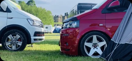

@Cam i got these on and have no issues, road noise or rubbing. I’m lwb and well soundproofed running spacers. If you look up @ABusAndBeyond they are runing these as well and did a video review
. Also I remember when first sizing them up some good advice from @chriscroft .... there’s a few others just do a quick search.
Heres mine
