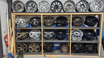

We stock nearly 25+ different sets of alloys.4acbfb49-0918-4247-a791-4f0d2150d260.webp

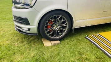

Hi mate !
Lovely rims you've got there
What brand are they ?
Thanks
Hi mate !
Thanks
@Stanfield - Possibly these?
Or the same:
They are self adhesive ones but they are metal and slightly domed. I just stuck them on the green Leighton centre caps. I’ve been asked before, but can’t for the life of me find the website where I bought them. Sorry.
