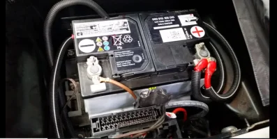

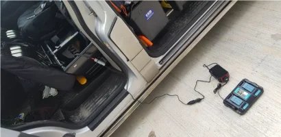

Quick question for those who work out of their van.. a mate has asked me what he needs so he can charge his DeWalt batteries from the van. He reckons he’ll only charge them when the engine is running, and thinks he won’t have space for a leisure-battery.
I’m thinking he just needs an inverter, unless anyone thinks different?

Makita do a car charger (cigarette lighter plug) for the 14.4 and 18v batteries. I think they are about £80-100.
i run tools out the van . . Makita 18v mostly.
the 12v plug version for the makita 18v batterys takes twice as long to charge. (compared to the mains version)
we just use a small pure sine inverter and plug the 240v makita charger in . . . . . thing is they can be power hungry. so van running or run from leisure battery.
there are some cloan makita 18v chargers that draw much less power (but take longer to charge)

this was my previous T5.1 van with a 1500w COTEK inverter for charging tools on the go.
powered from this leisure battery , , , , ,
running off a 150A SCR.
Does it have to be a pure sine inverter Lee? And I take it that having no LB means he needs to remember to switch the inverter off or risk draining the vehicle battery (unless they are smart nowadays and work out that the engine is off?)
Yes, must be pure sinewave. The sharp corners on non sinewave wave forms can cause this type of battery charger to overheat and fail.

the one i am using in the pic above is this one. ( i have two now, one for van and one for camping, it runs all the 240v stuff when off grid)
i also have two of these . . . worked great for camping again (TE cooler boxed and LED lights etc )
the 12v socket in the van is good for around 150W . . . it will start to get warm and will possibly blow the fuse at higher wattages. . . .
so for higher wattages i also have a collection of these to clamp onto the terminals . .
and in the above pics you can see i made up my own Anderson 50A quick disconect . . .
yes most will have a low volt shut off . . . . . but in my experience that is already too late. . . the inverter has shut down due to low voltage but its normaly around 10-11v which is to low to start the van.
i would say run the engine while charging to be safe (no flat battery) . . . or get a AUX battery setup under the seat.
