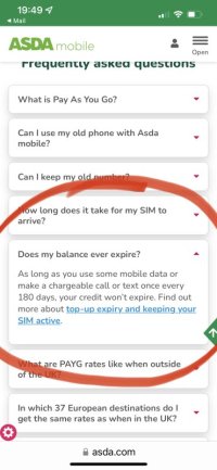

I think you’re getting confused with the “add-on” bundles. The base deal is a PAYG SIM, which is the non-expiring deal that I’m on. They are then offering bolt on bundles that are monthly deals, I think it’s these that are confusing the issue. Drill down to the base PAYG deal.
I don't think these long lasting sims area available anymore, that all seem to need topping up every month even if not used.
Giffgaff still do. We have one in our heater and the £10 isn't running out any time soon. I think perhaps it needs to be used every so often but if you had it send a message every month that's only £1.20 a year.

@Skyliner33. I've just seen the posts about sim cards so sorry for the late response. FWIW, I've got a GiffGaff PAYG sim in my tracker and can confirm that the credits do NOT time expire so long as you use it for a short SMS very 30 days. My van is not a daily driver and a £10 credit therefore lasts me a long time - I think I've bought £30 worth of top ups since I installed the tracker in 2019 and there's about £12 still there.

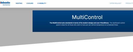

From the Webasto website "The MultiControl sets standards in terms of its modern design and user-friendliness. The dashboard control panel is ideal for all those who wish to have pre-set vehicle temperature at scheduled times."
Reading the part about 'have a pre-set vehicle temperature at scheduled times', it's quite obvious they are blatantly saying you can use it to set the temperature at a desired level of your choosing. It doesn't mention anything about ensuring the temperature in your footwell is maintained. It's misleading plain and simple as it suggests it is a timer AND thermostat - it has to be by their definition of saying it controls temperature in the vehicle.

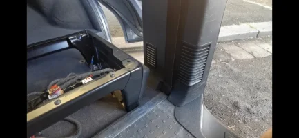

Shortly before my trip to Iceland this summer, I have fitted the Eberspacher D4 as per the original factory spec.
As folks said previously, if you're on vacation, you can't afford to have a chinese unit fail, so the options are either webasto or eberspacher.
For me it was critical to go fully original way as they build it in VW factory for higher spec vans.
During my installation as is done on the factory spec, I used all original parts except one (more on that later).
The total cost of parts was around 600 EUR because I managed to find main parts second hand in almost new condition.
The VW Eberspacher D4 has a custom control unit board so you have to use the original remote control as well:
The outlets are per the original factory style:
You can save a bit by modifying the original trim instead of buying the whole panel with vents. Requires extensive dremel work though.
The inlet is the only non-original part but I could bet anything - you couldn't recognise it from the photo below because it is a 3d printed model of the original vent.
I did the whole install right on the street on the parking lot in the city center.
You must install the plastic protection cover (not shown above) if you mounted your fan underneath the car body. I am using the aftermarket protection cover made of fiberglass because originals are designed to break in puddles so that you could pay more to VW :)
The hardest part was the electrical loom but all wiring diagrams are well known so after a bit of time, this can be figured out.
Extensive drilling and cutting is required to install all of this as per the factory way but this isn't a problem if you have the right tools.
After a bit of coding, the fan management is integrated into the van's climate control system (for example, the fan starts blowing stronger if you open windows during the operation). The remote control is visible via the can-bus and the heater module has a diagnostic pin going into the OBD terminal (as per the factory) so it can be diagnosed for faults either using the VAG software or using the Eberspacher software.
