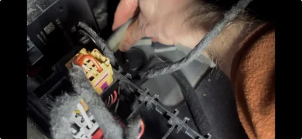

I planned to do a t piece like an original California night heater and mount the pump on the same bracket as the auxiliary heater pump.
It’s really popular to use the original ductwork in the b pillar and you can feed the electrics down to the heater through the original gromit under the right hand seat.
I would check original wiring diagram for dimensions of cables and mount it properly on the fuse box under the passenger seat.
I redid the wiring connection in my van as part of this video.
It’s also good to mount the air input in the step. The seal needs to be good so there’s no chance of recirculating exhaust fumes. a co2 and carbon monoxide alarm is definitely worth putting in the van. It Needs to be low down as that’s where these heavy deadly gases accumulate.
