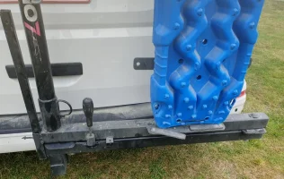

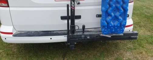

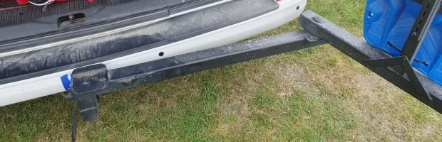

Some pics of my swing out bike rack i made. slides into the square reciver on the towbar and can be bolted in.
made with 2 pieces of 50mm square box, 16mm bolt at end for pivot.
Maxtrax holder as well and also has shelf brackets on back so i can sit the barbie.
20230104_094447.jpg20230104_094536.jpg20230104_094542.jpg20230106_133137.jpg20230104_094441.jpg
