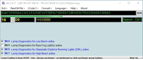

Could it be my settings in Byte 16?
I've read a few times on the forum that these settings are reversed, i.e. active actually means inactive, but still don't fully understand if this is just Bit 4 (Low Beam) or the whole group of settings?

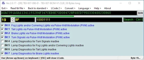

The other Byte I'm not sure about is 19.
Should all these PWM settings be active?
For a OEM LED headlights byte 16 has been either C0 (front/rear LEDs) or C2 front LED/rear bulb). However, there might be some variations because of fog lights (in the undocumented bits).
Thus for you unticking bit 4 would be first thing to try.
If not resolved please post the current BCM coding (as text).

Hi - I'm back earlier than expected so have managed to test the above @mmi. Here are my findings:
Unticking Bit 4 in Byte 16 gives me 'C0' for the overall Byte coding. Unfortunately, the faults still remain. They disappear momentarily - i.e. I can reset the fault codes, perform a re-scan and return no faults, but as soon as I turn the headlight dial to any position other than 'AUTO', they come back.
I've also tried 'C2' with the same results.
Interestingly, both 'C0' and 'C2' in Byte 16 trigger the bulb warning light on the dash, whereas 'D0' does not.
Another observation, is that sometimes I get just 2x fault codes for low beam, but most of time it's 4x faults (for high + low beam).
