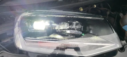

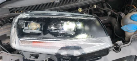

I have a 2008 t28 T5 i have t6 face lifted I am trying to get OEM t6 led factory headlights working
I have made some custom looms following some diagrams on here.i have got high and low beam working aswel as the indicator but struggling to get drl and side lights working any help would be greatly appreciated
Attached photos of testing lights
