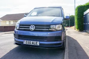

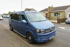

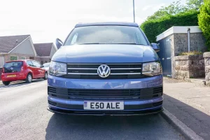

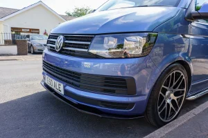

Bit of progress today. Eventually got round to fitting my new bumper complete with Maxton splitter and Caravelle grille. Cant believe how much better it looks! Thanks to @Gingercoastie for the bumper and @Pauly for the trim pieces.
BEFORE (Forgot to take a before photo today)

AFTER
28624525977_9e5e6d05a5_h.webpVWT6-2.jpg by VW T6, on Flickr
28624528057_fca3f450ba_h.webpVWT6-3.jpg by VW T6, on Flickr
42794216744_73143b784e_h.webpVWT6.jpg by VW T6, on Flickr
The colour is a slight mis-match so I am going to get the wings blended later. I would have normally got that done at the time but the painter didnt have the van, just the bumper
