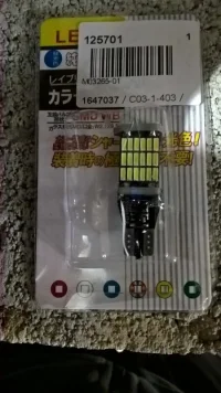

Have you done the front and rear indicators as well Studley?Just what i put in mine![]()
Have the reverse led been OK ? Any light out warning.I did the rear indicators with the same LED in amber but got the bulb out light and fast flash so i took them out, they need resistors but dont no where to put the safely because of the heat they produce, so i shelved that one for now. I have done the sides, all fine, but i image the fronts will do the same error + i cant get me hands in there.
If all good have you got a link .
Cheers
Cheers @StudleyGlass order placedFound them. I think there the same as @DaveyB has just fitted and a few of us.
https://www.amazon.co.uk/gp/product/B01LCN5XD2/ref=oh_aui_detailpage_o00_s00?ie=UTF8&psc=1
