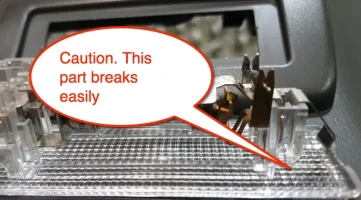

I’m trying to replace the interior light to LED bulbs. All done
when I trying to remove this clear plastic but can’t
Anyone can help me how to remove this
Thank you
Pull and wiggle but they can be quite tight
I use a pair of pliers with a bit of tape over the ends to protect the glass
@fezza68 any chance you post some pictures up when they’re all installed please, been meaning to upgrade mine to led.
Where did you purchase the kit from if you don’t mind me asking.
Yeah its the cab light from my shuttle,its the ones in the rear that i need help with...sausage fingers and the touch of a rapist like i have is a definite way to break it..lol
Il put up some pics when my mate who has a body shop does them for me on monday.
Got the bulbs out and the leds I got from travelinlite don’t want to go in,they look a bit thicker if that makes sense. Anyone who has done this mod got any links as to where they got theirs from?.
