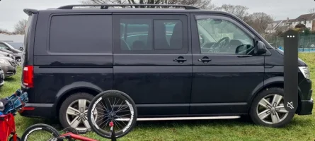

I bought my bronze wheels, just before the supermetal chargers came out. If anyone wants to see what they look like on an indium grey van, he’s a taster…think I’m going black…or grey…or black . I’ll be selling my bronze too
Love these, sadly only available in 20”, looking to swap my alloys to 19” now. Gutted as I love these.
