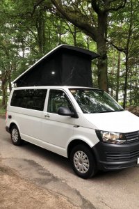

recently got a 2018 t28 t6, it’ll be converted to a camper. Looking at suspension options what do you think of the below?
VW T6 Eibach 50-60mm Lowering Springs & Bilstein B4 Dampers
T6 Eibach Height Adjustable 50-60mm Springs & Bilstein B4 Dampers for a T26 - T28 - T30, VW Transporter T6. Super fast delivery to Mainland UK.www.veedubtransporters.co.uk
not looking to go crazy low and will likely be running 20’s.
cheers
Thanks Steve, appreciate the comment. Would you say the B14 coilovers are a better option?Don’t touch it. 50 to 60 mm is a lot for the very capable shocks we fit. The B4 aren’t performance shocks. They won’t cope at all. , please rethink this before you waste a lot of money ! Those shocks won’t cope well with the additional unsprung weight of the bigger wheels either !
No I would say thats the worst option. That is one of the kits we remove all the time. sadly the guys selling that kit don’t have much else to offer So that’s what they sell. Research on here about B14 spring problems , it doesn’t suit campers because the rear springs are poor design and break a lot !,,, there are much better options . Have a look on the Bilstein web site to see how good that kit is actuallyThanks Steve, appreciate the comment. Would you say the B14 coilovers are a better option?
