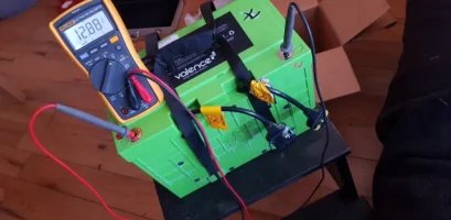

I've just completed my under seat leisure battery install.
It's a limited capacity setup with only 32Ah available but it's lithium so can use 100% of that compared to 50% of an AGM battery (and that's often only 50Ah from a 100Ah battery).
I've included:
  • DC-DC charger (wiring needed to complete) with MPPT solar input up to 120W (for future)
  • EHU charger (wiring to be run)
  • 300W inverter (a bit limited) and two 240V outlets under the driver's seat.
  • Cutoff switch and fuses for 12V applications, and panel with four usb outlets to rear of drivers seat.
  • LCD battery monitor to rear of seat showing charging input in watts and DC&AC outputs in watts.
  • Components all boxed together and removable for use in the awning, without removing the seat.
  • Plenty of space for a second similar setup under the seat (non-swivel).
  • Managed to do the whole job for under £400.
I need to do a bit more work to stop the battery moving but I think it's a pretty neat setup.
What do you think?
Actually £365 delivered
In case you're as surprised as I was when I went out to see whether it would fit under the seat, here's some household objects for scale. It's not quite as wide as an iPad or Nintendo Switch, just taller than a beer bottle and as deep as a beer bottle and a tape measure. If it was anything else I had bought online I would be seriously annoyed that they mis-sold how small it was, but this is astonishing. I'm serious that you could fit two under the seat if you removed the rubber flooring.
I know it's not a serious contender for a leisure battery install if you have a fridge, but otherwise, with a 120W solar panel I'm totally serious about this being my install for this year.

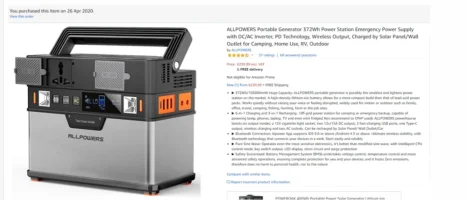

Agreed, these packs do have a place . . we uses them all the time at home, work and camping.
one even run the T6F Summer Camp DiscoTent in 2020 . . i liked it so much i bought a second one.
we use the ALLPOWERS 372 Version: its only £240 or £225 with voucher.
we done some testing, and while its was fine for mobile applications we found it was only 1/3 capacity of the big Green Lithium (138ah)
and was limited to 60W charge rate, so could be slow to charge compared to a proper DC-DC seat build.
