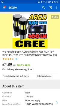

Halfords did mine, 130% ones. £47 and one year guarantee if they fit.
Seemed fair to me as my hands are not made for getting into those tight spaces :)
I used these bulbs - one has recently blown and not had that long. Need to get the receipt fished out as not been in 12 months

I've changed all my headlight bulbs now. It's not the easiest thing to do but definately worth it not to have any yellow.
Can't comment yet on the brightness of the Phillips racing + yet because I've not driven that late yet but all the leds are working and not showing any faults
Dipped is the Phillips.
Side lights are the leds.
The drls I can't find them but I bought them off eBay.
Foglights I'm yet to sort as there are very mixed reviews on the bulbs being white but not actually putting out a great amount of light.
