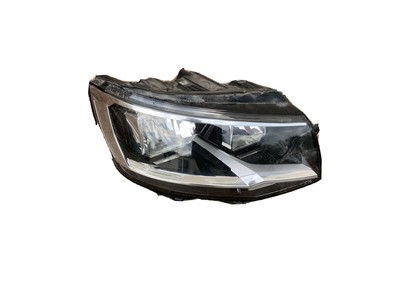

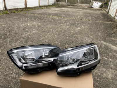

Right, the anatomy of a H7 Headlight ?
Not sure if something is missing comparing it to the picture of the melted bulb holder...

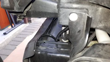

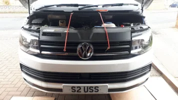

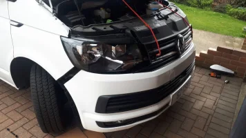

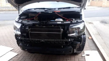

Was the wiring easy enough for the drl's?I got round to fitting mine yesterday. Phase 1 of 4 for this year. If I'd have known what difference they make, I'd have pulled me finger out a lot earlier. I'm really impressed. No error lights on the dash - Everything worked perfectly, even the level adjuster for when towing worked without issue.

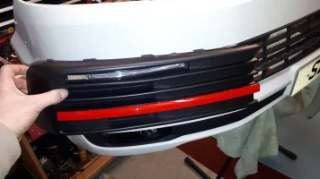

I also installed the DRL panels from Travelling-Lite. They were an easy job while the front end was off.
View attachment 109911View attachment 109912View attachment 109913View attachment 109914View attachment 109915View attachment 109916View attachment 109917

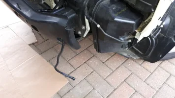

Thanks for the offer.....very kind of youYes it was pretty good tbh. I was scratching my head a bit initially but I was over-thinking it. I wouldn't like to tackle it with the bumper still on but it must be possible with the undertray off so you can work up rather than down. I don't mind simple electrics and this was pretty easy. The hardest part was tapping into the N/S headlight block connector. Now I've done it, it'd be simple to do again although I used a soldering iron & heat shrink tubing rather than the supplied posi-tap connector. The harness is already made up and has decent splash proof connectors.

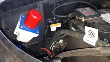

Happy to help if you decide to get some. I'm near to J31, M1. The Control module mounts near the battery - pic 5 in the last lot.

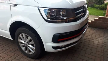

Is it me, or do the the DRL grilles stick out further than the originals? I've been hovering over the buy now button for a while, but now seeing them fitted without the sportline sticky out chin, I'm not so sure.
There's the difference that I'd not noticed before when seeing them fitted with a sportline spoiler.
I hadn't realised this myself, either. It does stick out quite a bit IMO. Its certainly noticeable with the lighter coloured vans.View attachment 109962
